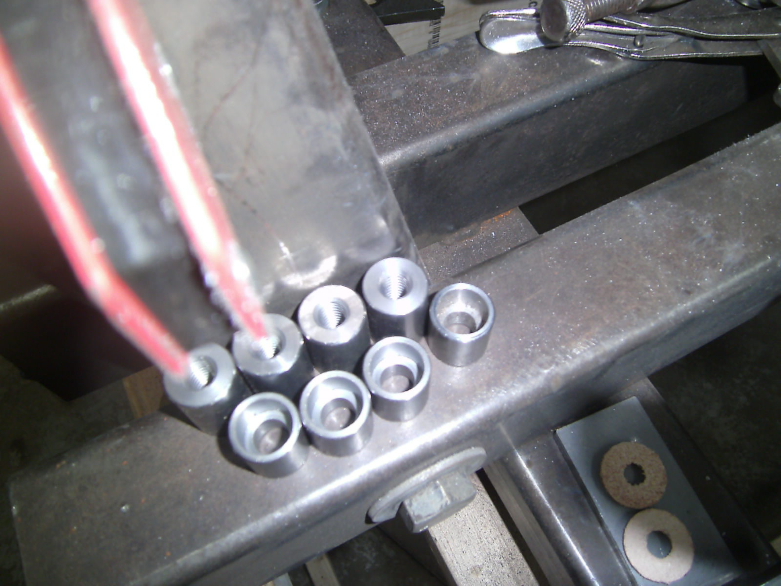

picked up a 6inch flat fender ,mount and some bungs i kind of like the recessed ones for allen head cap screws . not much progress with the welding i been kind of busy with work seems like im going to have to buy my own tig welder so it might be a little bit till i can afford it . i knew going in this was going to be a long term project but it will get there

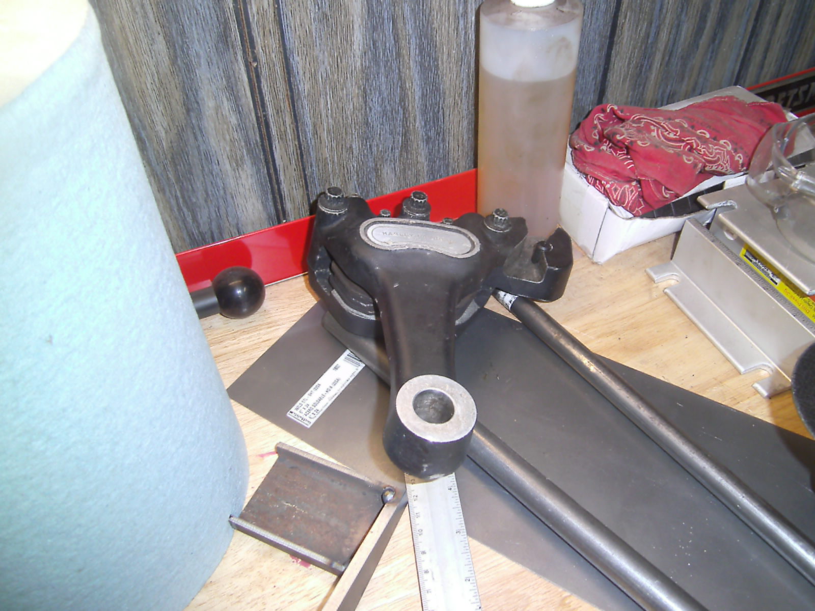

i know i havent made a lot of progress but i knew this was going to be a long term project i been pulling some parts together picked up the shorty for free needing a rebuild but looks in good shape and started a sissybar build for this its 2 6foot long 5/8 bar and a piece of 3/16 flat for the fender to rest on . ordered the tig welder today so i should be able to start making some real progress soon . probably wont go much farther with the sissy bar till i get the welder either so i can make sure everything fits the bike well and looks the way i want it to
