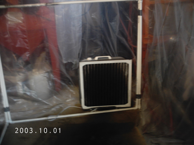

Parts in the jig * hung in my temp booth.It worked better than I thought so now I'll build another problbly out of metal studs.The weight of the rim really put the small diameter pvc to test.I aslo put a box fan in with a furnace filter to draw & capture the overspray.That worked great as you can see in the pic...filter turned black
