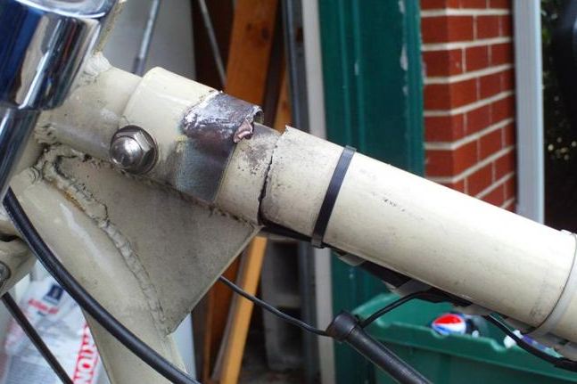

The importance of using the right materials and also being able to weld.
This was a "homebuilt" frame .

Re: Where to have welds tested?
the guy that rode that is a brave soul
Yeah, they look shitty welds (not 'melted' into the parent piece at all) but look where it snapped
ya bad brace design too
What's wrong with the Gusset?
- Posts: 1103
it looks like the brace is what caused it to break where it did and looks too small . i know i read somewhere when i was first reading about building frames maybe in gary's writeup but not sure that ya gotta be careful with the front brace because it has lots of stress in that area
Yeah, something about NOT mounting gussetts on the tube center line.
Mine is similar in size.It is mounted off center.I would guess a break like that could happen without much warning.
Ok, Jeff, lets cover the 2 basic issues with that design. First, the straight trailing edge. The stresses and energys are transferred directly from the lower tube to the upper in a straight line. The deep scallop in the trailing edge of the one from Hans redirects the stress/energy and spreads it across the far side along the line instead of a focal point. Second, the tube deflects energy when gussetted closer to the outer edge, again like hans, and its absorbed through the structure. With the centered gusset the force it absorbed across the tube instead of along it, the focused energy causes metal fatigue and the failure. The ends of the break are bound to be crystalized.
