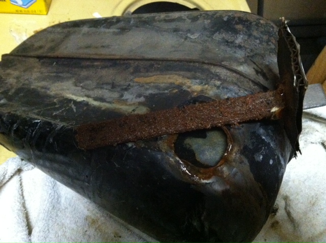

This is goning to take some time.I checked the Process after about 2 Hrs. run time & this is how the Anode looked

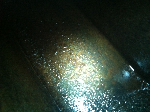

.This is the inside of the Tank after the 1st run .May be hard to tell,but there is a marked improvment.Trhow out the Solution & make up new every run.I'll do this for a couple Days & see how it works.Changing the shape of the Earth...1 bucket at a time...IUOE local 825 top of the food chain

After talking to some more People, they say that the Anode having to be in site of the Rust is a little unfounded.The reason being this an effect of Electricity & the Charge is being sent through where ever the Water is.So....I'm going to continue untill the side of the Tank I can see is clean.I still intend to cut the Tank in half to have peace of Mind.This is what the Anode looked like after the second run at 5Hr.So it is pulling a good amount of Rust off the Walls.Unfortunatly I have to go back up North for the Week & won't get to do any more till next Weekend.

Well.....I got delayed going North so I was able to do a couple more runs.There is a lot of Shit that won't come off.I think it's old...very old 2 Stoke mix.I cut the Tank in half.The process was working, & I think it would have cleaned up pretty well.Even the other side of the Partition was cleaning up.You can see the dark areas in the Pic.
