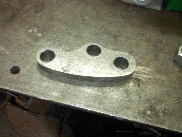

well it looks like im not as done as i thiught i was i put the new rim on and because i went off the plans a lil with the bottom of the tubes the rims dont fit . the hubs are wider on the rims than the factory hubs im thinking i can make extended rockers and change the hardware a lil and make it work its gonna be tight but should work . illl have some pics tomorrow i started making the rockers already was sanding them down when the belt broke on the sander so hopefully i can get back on track here so i can get theese running by spring

the pics are outa sequence but i took the origonal rockers off and made newones i havent had a chance to replace the hardware yet but took some pics to show how tight its going to be for the brake rotor i think itll just fir if i change it or maybe cut the heads off and weld em in now i wish i had made the style the plans call for try and cheap out not paying to have the machine work done and ya still pay in the end oh well next time ill be doing it by the plan but i did get it centerd and turned down the spacers fix the hardware and make the axl then brake mount and done with springer

Iam sure you'll figure that one out! ...anyway you could counter sink the bolt heads or machine the hub ???
