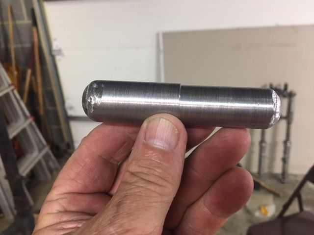

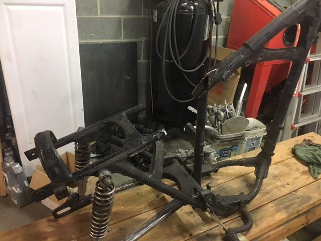

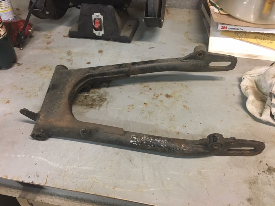

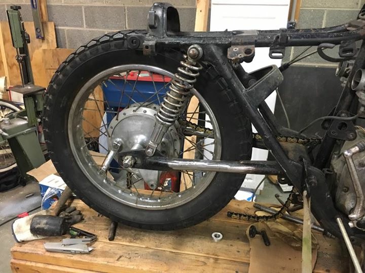

Not a chop, but hope ya like. This bike my younger son & I are building. 1st on the list was to give the rear a slight stretch...2 1/2".
I forgot to take pics of the slugs oh well.
Posts: 693

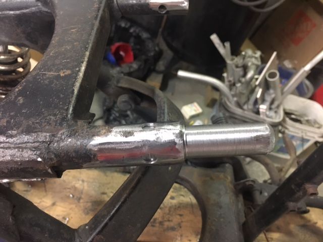

Re: Double shot of Cafe

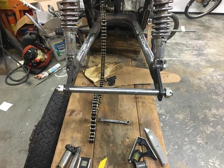

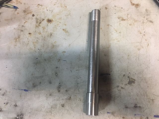

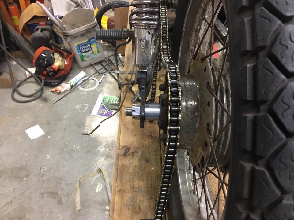

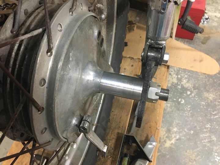

After the rear was stretched, it made the swing arm a little wider so the axle was to small. Made a new new in stainless
. Then a couple of aluminum spacers were made

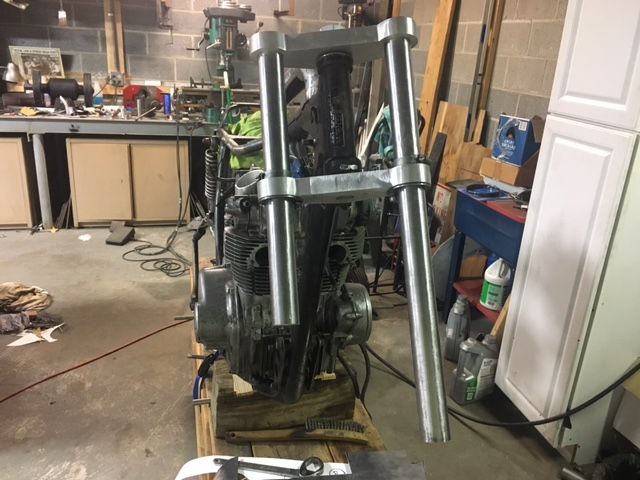

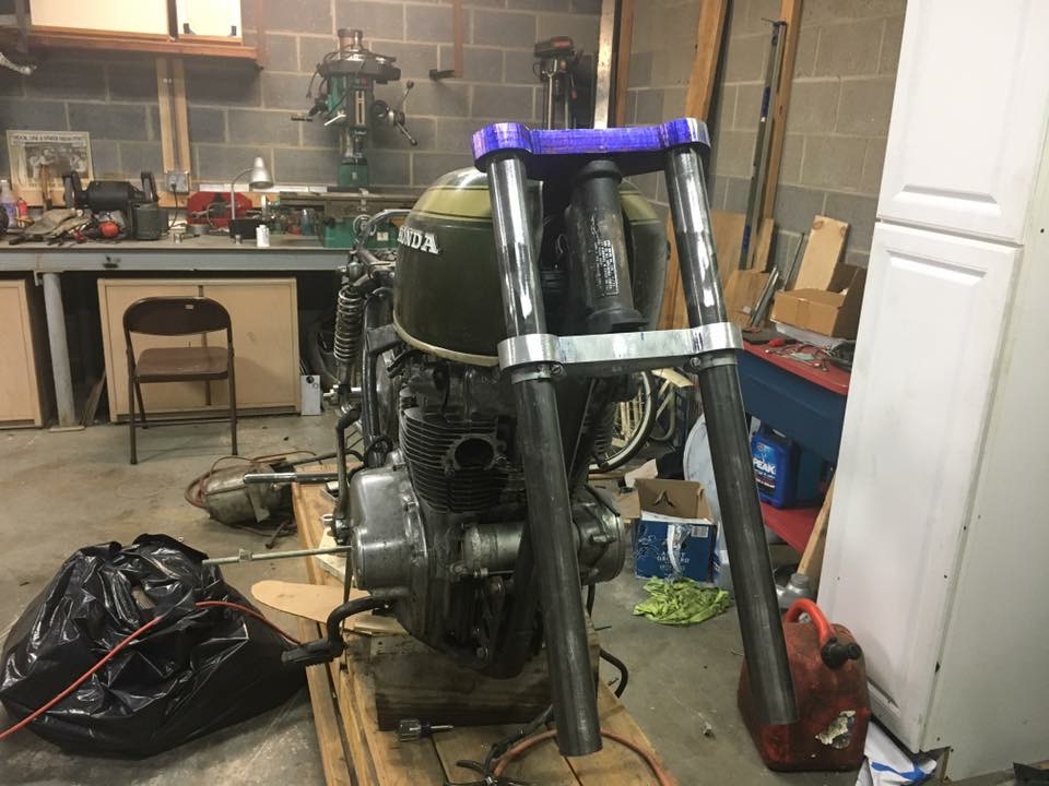

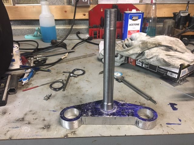

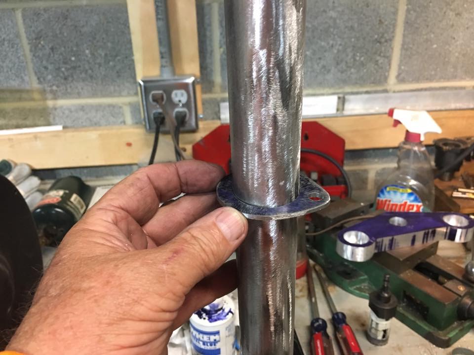

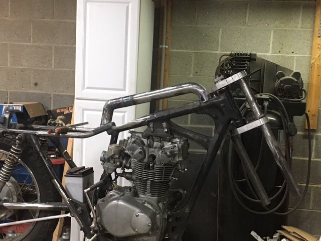

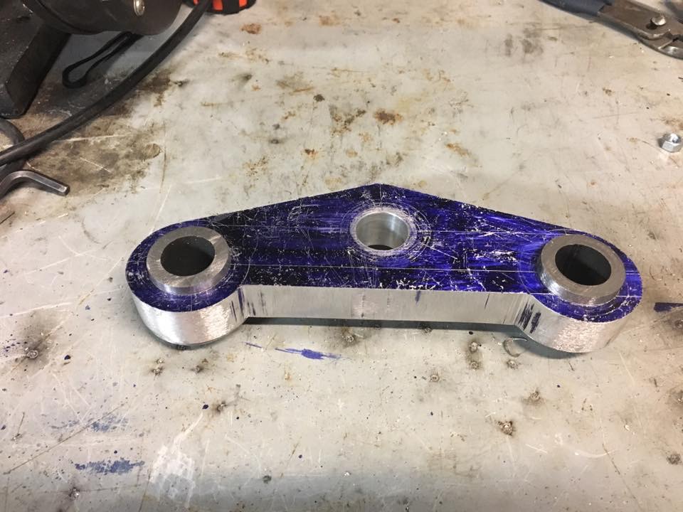

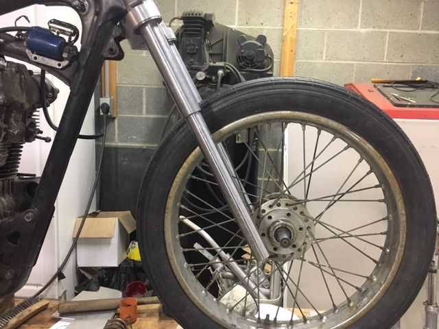

We wanted something different for the front end, so we got rid of the stock one. We came up with the idea of an inverted springer. A set of trees were made out of wood to see what we needed.
. The stock trees have 2.5" of off set, ours has 1", cause the rest & possibly a little more will be made up at the rockers. Aluminum trees were cut
Posts: 693

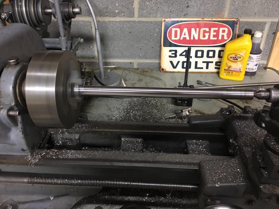

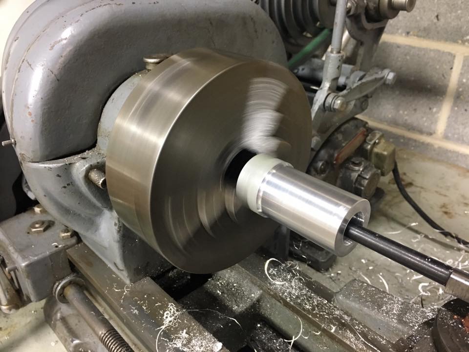

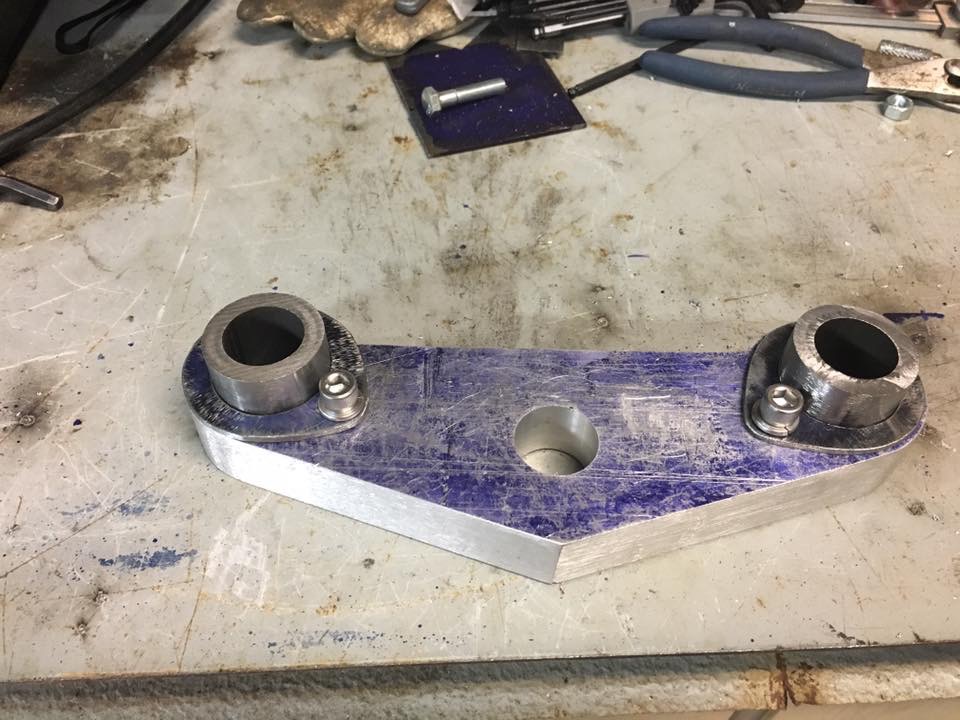

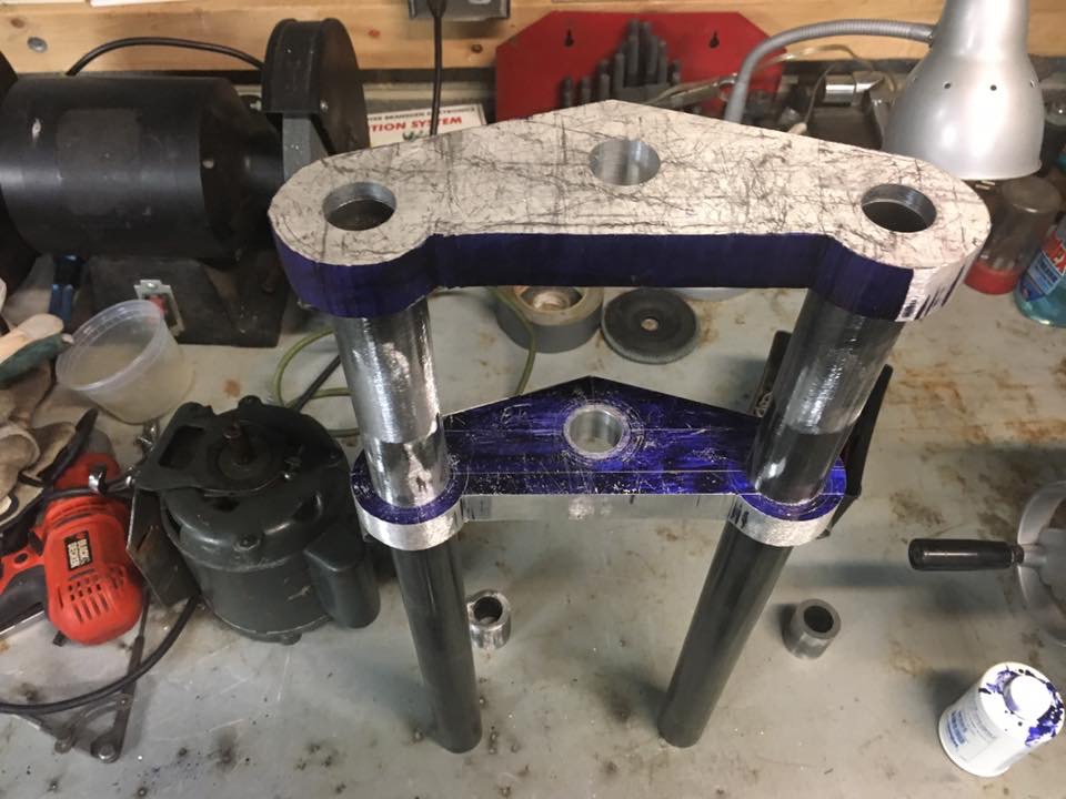

1.5" tubing is used for the upper part of the forks
. The lower portion will be thinner like they would be on a inverted hydraulic front. Wanted a real clean look without pinch bolts. The forks will attach to the bottom of the trees.
these will be welded to the forks
then bolted to the tree

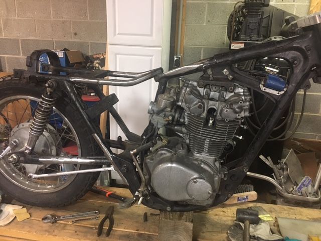

The seat posts are in the way for the split tanks we plan on building, so the had to be moved.
After they were cut out, slugs were made & installed.
. New tube was bent & welded in plce

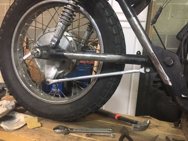

. They will attach to a false back bone (easier than cutting out the original) that will hold the starter switch, a few other switches & maybe the hi beam & neutral lights. The tank will be home to the tach & speedo. Also started on the brake stay
& we cut off some brackets to clean up the frame a little.
I made my steering stem, & its a .003 press fit in the tree
. Trees all fitted up

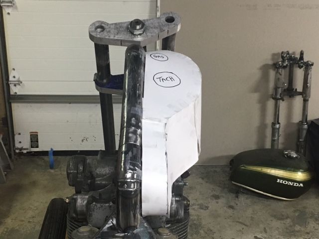

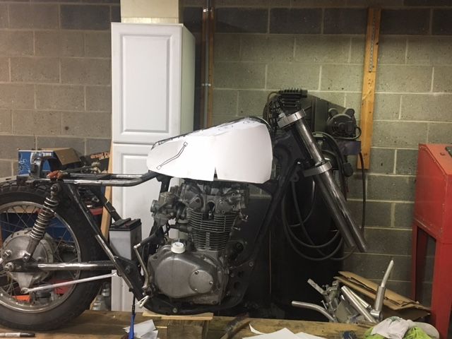

Got the shape of the false back bone & tank pretty much set.
, The tank will wind up being a little lower than it is in the pic, cause I did a little more trimming after the pic was taken.

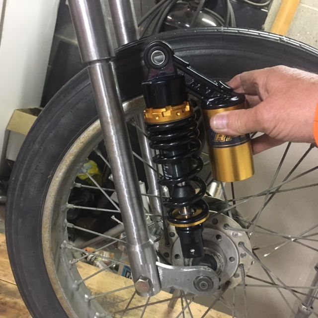

The upper tubes finally got cut down, & lowers fitted in. Shocks should be herein a week. Then I can figure out rocker shape, mounts for shocks, & make the slots for the rockers.
Posts: 693
The lowers were remade to add more meat at the bottom. Slots are cut. Gonna make up the rockers & shock mounts in wood this weekend.
