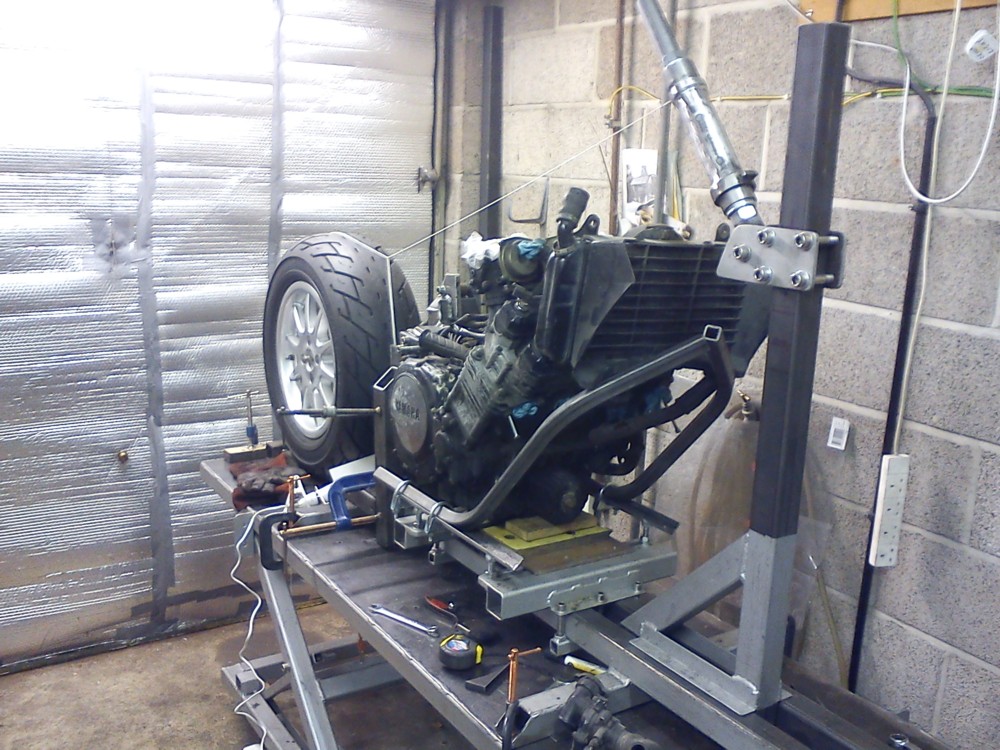

Anyways, here's the latest progress on the FZ 750 project....
mazfz750 010.jpg (191.58 KiB) Viewed 9476 times
mazfz750 011.jpg (214.95 KiB) Viewed 9476 times
mazfz750 012.jpg (208.41 KiB) Viewed 9476 times
I've fabricated all the rear motor mounts and started mocking up the lower frame section using the pieces I made last year..... :think: quite a lot more mocking up to do before I'm completely happy with it....

Love your rear. What size tire is that Maz? Looking very good.

msn1977 wrote:Love your rear. What size tire is that Maz? Looking very good.
Thanks dude, the tyre is a 230/60x15 Avon on a 7x15 rim and the single sided swingarm is Honda VFR with a MazChopz fabricated hub adapter/spacer......... :shifty:
The rear tyre looks wider than it is because the 4-cylnder inline motor is actually quite narrow and I personally feel that is the widest rear end to give reasonable cornering on a long chop......
