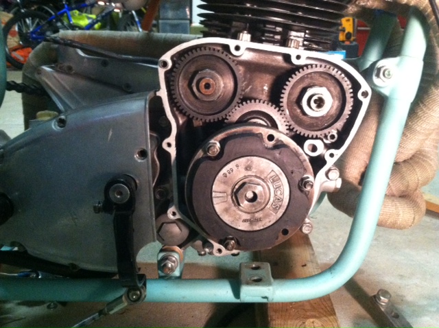

Thanks for the thought Dan.Hopefully I'll go back to work soon & Money will start rolling back in.Anyway I did get the Timing side buttoned up today
timing side.JPG (143.34 KiB) Viewed 14126 times
The Primary is just about complete.I realized I missed a couple small Parts that will need to be ordered(no big deal)I also made up the Spacers for the front Axle.The Shifter works,but the cross over that I made is slipping a little.I drilled a hole in the Shaft that holds the Linkage & drove in a Roll Pin so hope that will hold...find out Tomorrow.Expecting the Gears for my Tranny & Carb Parts to be here by Sat.Thats it for now.

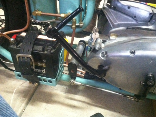

Wow...I start gettin Antzy waiting just a week for parts.I got the Shifter Linkage back on & pinning it did the trick.it works pretty good.I've had this Part in the back of my Mind since I made it, cause I wasn't able to test it till just recently.I did need to bend the Handle back a little...it hit my Leg when I shifted, but all in all I happy the way it turned out.
I think it fills in the Space without being to unsightly.I think I'm gonna strip all the Parts I Powdered in Black & polish the bare Metal & throw some clear Powder on them.

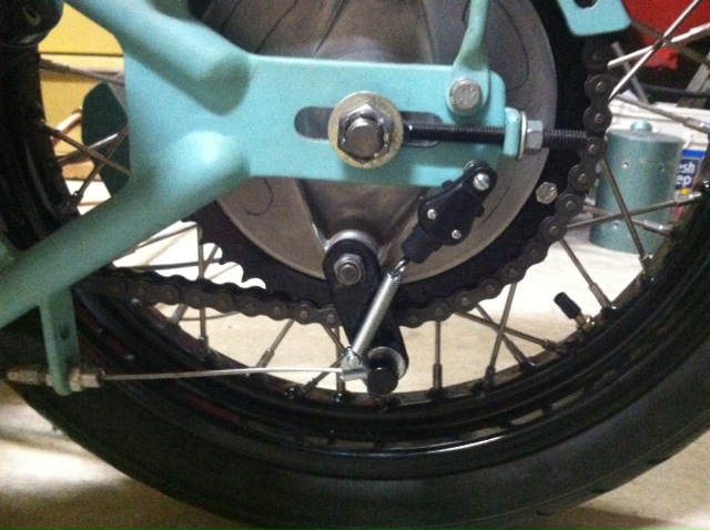

I got light....started to run some Wires & Tail Light & Brake Light are working.I'll wire the Head Light tomorrow.I got Paper work coming to get started on getting a Title.
