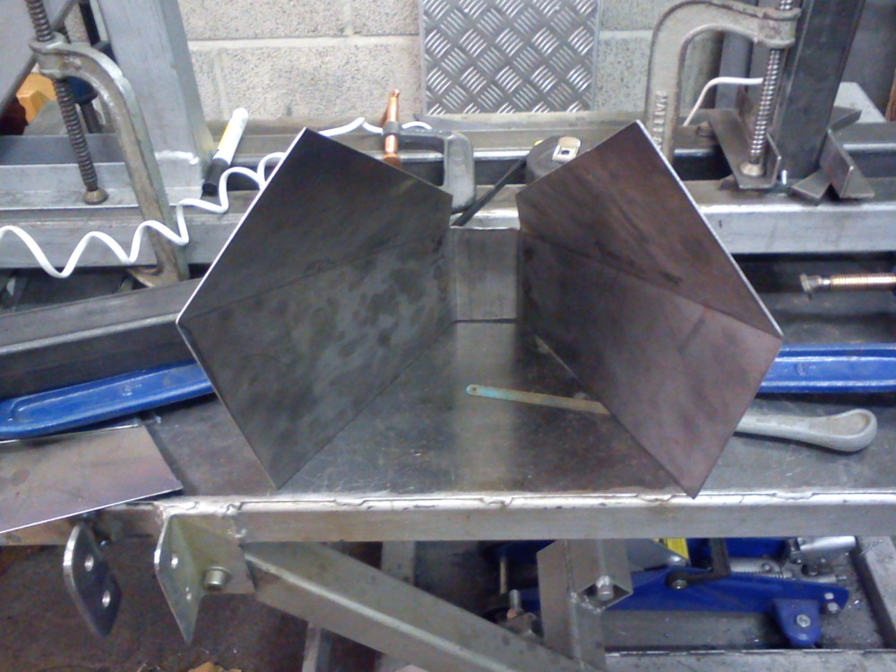

Anyway, tonight I got busy with the 9inch disc cutter and my metal folder and here is the progress so far....
Main part of rear section marked and cut out....

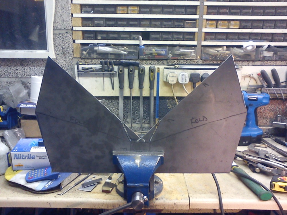

first folds done.....

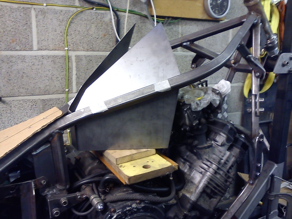

trying it in the frame......

Interesting look to it, and nicely fills the void between the frame members. Got more coming for the front?

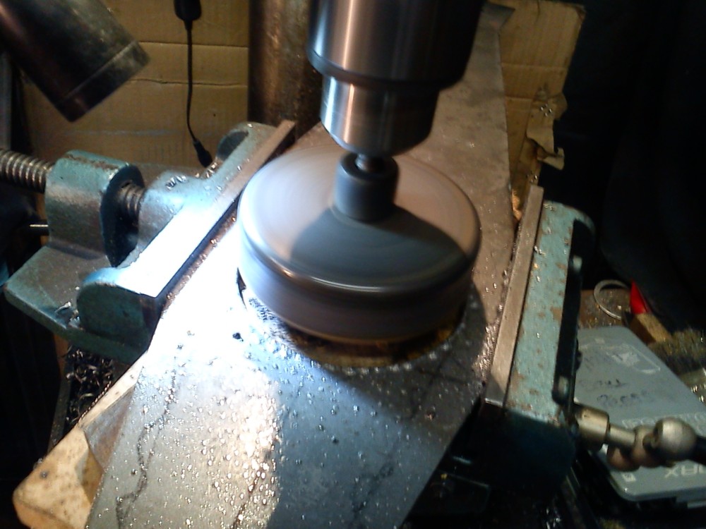

Thanks Bob, and yes there is more coming for the front, there will also be a space under the front for the induction system and coils etc.....I've marked and cut out the main front top piece and there's a pic below of me making the aperture for the filler cap - using the original Yammy aircraft style filler.....
