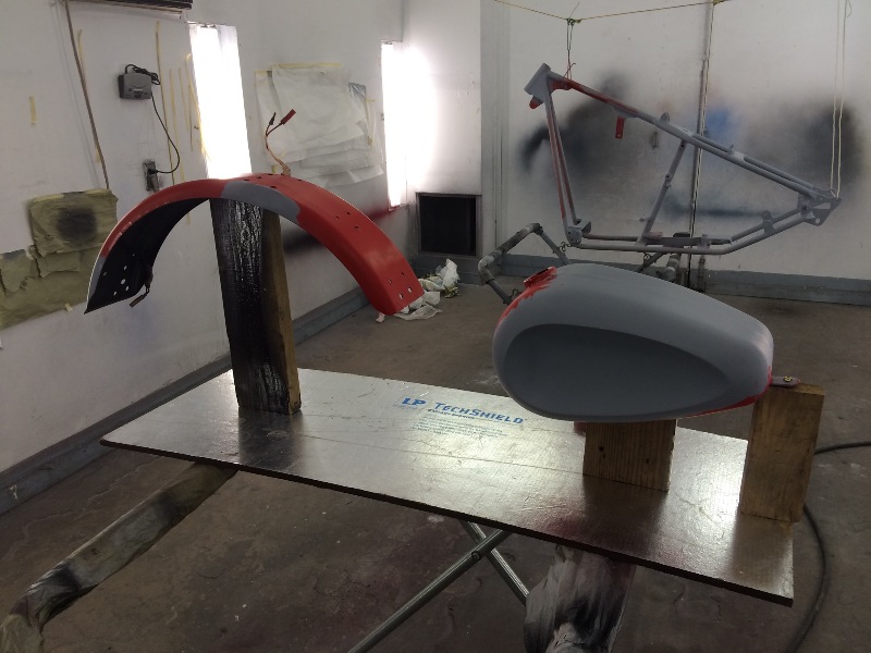

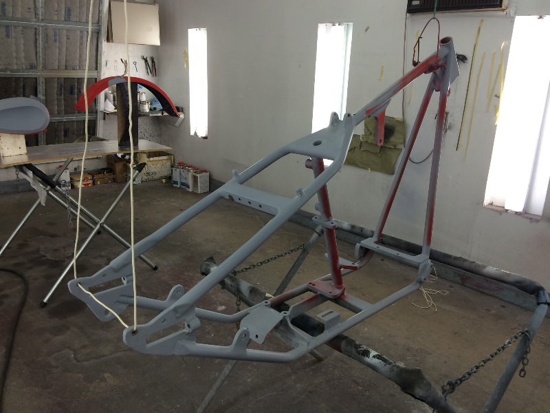

Well, I might be moving slow, but at least I'm moving....
Did some more prep work on the frame and tank and rear fender to get a better finish.....
Got yer shades on ??
More pix here
Willy
More pix here
Willy

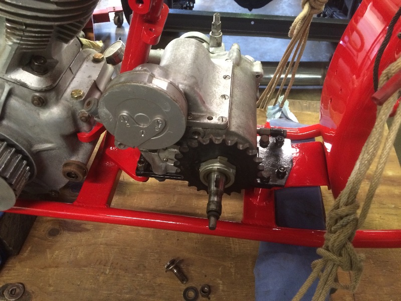

Lookin forward to seein yer pix...
Got some parts cleaned up yesterday, gook and rust removed, and painted.
One was the tranny plate, had a little bit of time today, so snuck out to the shop and put the tranny in...
Don't like these bolts, so will get some new grade 8's and replace them....
Actually, the front ones are slightly too short, and do not fully engage the nylock nuts, interesting, as they did in the stock frame, so this Denver Mullins frame must use thicker stock for that front mounting flange. The local store did not have nylocks in the 3/8" fine (SAE) thread, which is what I want to use, and what the oem used. So I got longer grade 8 SAE bolts with grade 8 SAE hex nuts, and some SAE lock nuts to put on top of them. Will show pix when I change 'em...
Started working on the rear brake, all looks good, it was in good shape, was working just fine when I shut the bike down in 1990. I just got a rebuild kit from the local Napa store for this size cylinder, includes rubber cups, end covers, and a new spring. The old pistons are in good condition....
The wheel cylinder was a little rough looking inside, so got my small brake hone and cleaned 'er up...
Wish my insides looked this good !!
Put the rear brake parts together with the rebuilt wheel cylinder...
These are the same parts that were in the bike when I last rode it...
The parts to mount it in the frame needed some scrubbing and fresh paint...
Waiting for the paint to dry...
Willy
