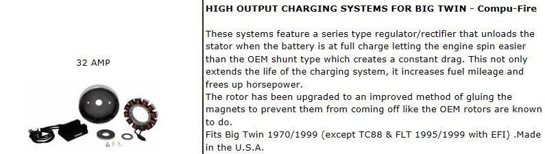

Thanks. I should have the charging system waiting for me when I get home. Going to look at some recycle parts today.

which system did you choose?
was it spendy?
was it spendy?
COMPU-FIRE
In Canadian $ it came to about $280.00 inc. delivery.
- Posts: 939
Re: Slow Build
sounds reasonable for quality.
been a long time since I researched this, but I remember Compufire having good reviews.
Re: Charging Unloads
Apparently the OE shorts to ground when the battery is fully charged.
The way compu-fire works sounds like a better system.

sorry, you said charging system, but for some reason I was thinking electronic firing.
Didn't realize companies were making charging systems.
I had problems with the OE stator magnets myself, on a trip from Cal to New Mexico.
Had a hard tail wind, started feeling some very slight difference in something, wasn't sure what was going on.
After awhile, it kept happening more frequently, so I exited at Palm Springs and found the dealer.
That was about 1994, bike was relatively new (1991), and they worked for hours before diagnosing it as a battery.
I took off, got a mile, same thing.
Went right back. They wound up working on it for at least an hour or two past quitting time, but got it right finally.
The magnets had just started to come off, only a couple so far, and the trouble was intermittent. That's why it was hard to troubleshoot.
I wound up getting another new stator years later for different reasons.

I thought so when you mentioned Crane HI-4. I don't know what is in this evo but I don't think it is Crane HI-4.railroad bob wrote:sorry, you said charging system, but for some reason I was thinking electronic firing................ They wound up working on it for at least an hour or two past quitting time, but got it right finally..........
The magnets had just started to come off, only a couple so far, and the trouble was intermittent. That's why it was hard to troubleshoot......I wound up getting another new stator years later for different reasons.
There are some great super-adhesives to hold the rotor magnets on. Unless they had a replacement rotor , this could be how they repaired your '91.

it was a replacement.
