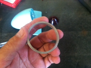

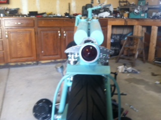

On a whole other note....(fuckin ADD is great isnt it?)....no wonder I never finish anything.I picked up this glass lens for my tail light some time ago
...cool I think...but it doesnt quite fit.
...so I made this little spacer...with one of my favorite caveman tools...the trusty hole saw & I used the boring bar on my shitty little mill.
....And here it is fits like a glove now...
....the only thing is it doesnt have any clear glass for the lisence plate....but fuck it
Re: 69 BSA Rocket3... the Unholy Virgin
A super brite white LED could fix that .... small and bright ...!!
Right now the bulb is a regulal old 1157.Are you saying replace that with LEDs or add them for the plate?Brighter would be better.
