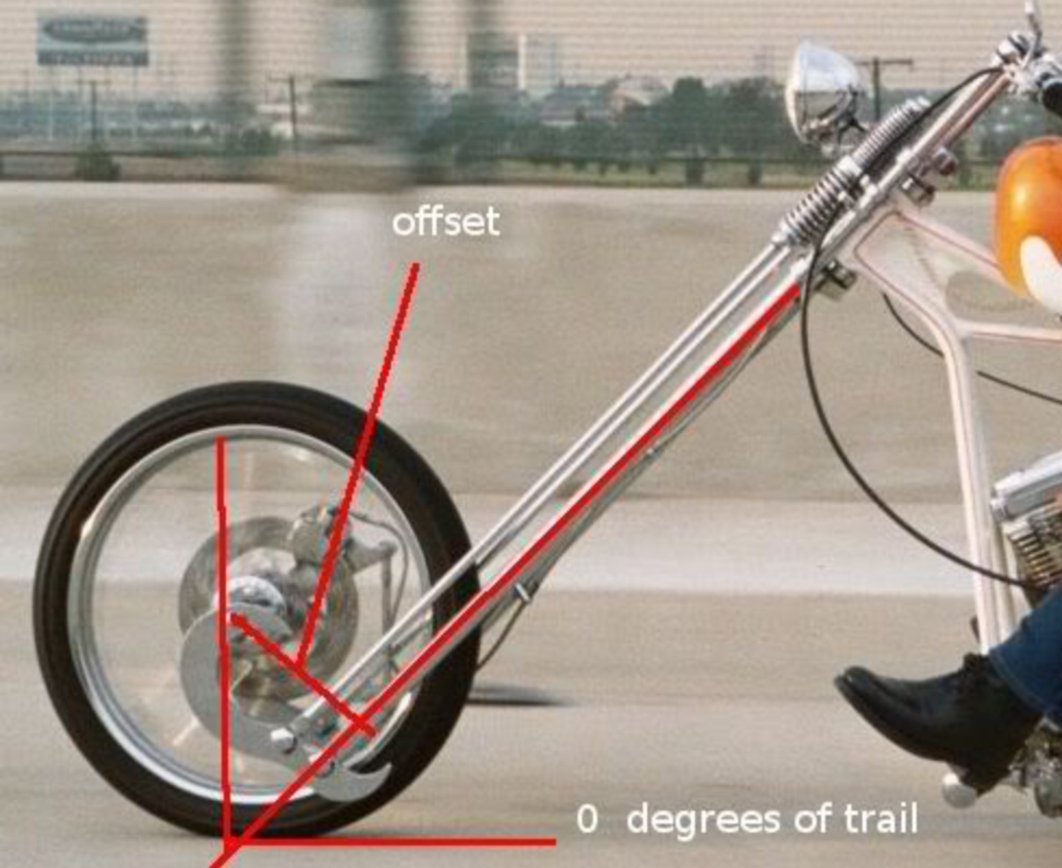

Sb
Sb
SugarBear seems to have offset trees . The imaginary line is shown drawn on the rear leg and not through the neck.
Your trees are offset too.
Your line to the ground goes through the rear leg as well. I am assuming that by looking at your cardboard drawing.
Drawing it this way, is the result true zero trail ? I am not an expert at this.
Re: Honda Rebel 250 Springer Build
Yes, I have offset trees also. It may appear to use the rear leg. But The steering stem line is used. Sugar Bear runs 0.125 to zero trail. Mine is setup for 2" trail on purpose. Something about playing with the negative side. I'm not that brave yet. LOL (to push it any closer than 2")
