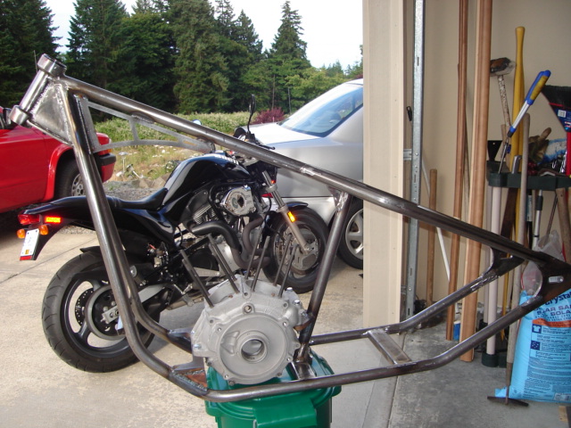

Re: Slow Build
The existing axle plate setup.
This was last year. It is more complete now,  than pictured.
Re: Slow Build
I like both set ups.Your fame looks sweet as is, but if you want to change it, now would be the time.
Re: Slow Build
Does look neat though Hans...

Here's the frame as it is now.
I posted this one in "File & Fit" on the previous site.
Re: Slow Build
Thanks for the input. I am going to cut down the size and finish the tube ends.
I do prefer Gary's non adjustable. I am taking the easy way out.
