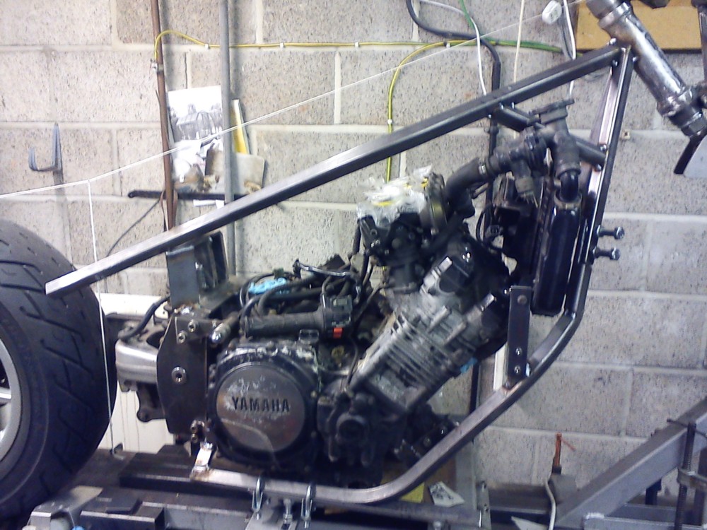

So I've been busy making a few small parts from billet aluminium (I'll post some pics in the machine shop section...) and I also mocked up the split front down tubes and radiator....
mazfz750 034.jpg (166.69 KiB) Viewed 7967 times
mazfz750 035.jpg (195.04 KiB) Viewed 7967 times
mazfz750 036.jpg (161.68 KiB) Viewed 7967 times
I still have quite a lot of fabricating to do but I'm pleased with progress so far :snooty: this is going to be a seriously radical punk style bike but she sure ain't gonna be pretty :naughty: :hand: :doh:

Do you have plans to make some sort of cowl for the radiator?
Re: Maz's FZ750 Project
Jeff L wrote:Do you have plans to make some sort of cowl for the radiator?
I'm planning some sort of cowl for the rad but I'm not trying to "hide the ugly bits" as this is a Domme-Punk bike and is not intended to look cute or pretty......
